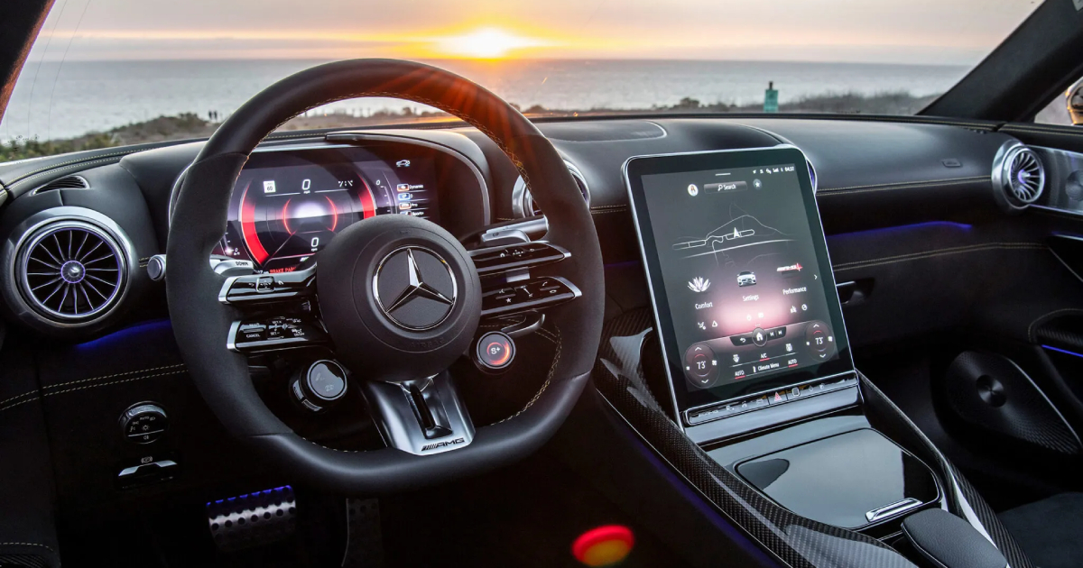

Mercedes-Benz USA filed a formal recall on May 1, 2026, covering 144,019 vehicles from model years 2024 through 2026. A software bug in the multimedia control unit can trigger an unintended system reset, causing the fully digital instrument cluster to go blank — taking the speedometer, fuel gauge, and warning lights with it. No crashes or injuries have been reported, — per Yahoo Finance / Reuters.
What's going wrong
The multimedia control unit contains software that was originally designed to improve system stability. Under certain conditions it launches a reset sequence as part of its error-recovery routine. During that reset, the instrument cluster loses power momentarily and stops displaying critical driving data. The gap is brief, but losing speed and warning information at highway speeds — or when the fuel level is critically low — creates a genuine safety risk.
Mercedes began pushing a corrected software version via over-the-air (OTA) updates in August 2025, well before the formal recall. About 62% of the 144,019 affected vehicles already received the fix remotely, — per Carscoops. The remaining 38% — roughly 54,700 vehicles — must visit a dealer for the same software update because their hardware configuration does not support OTA delivery. The remedy is software only; no parts are replaced.
