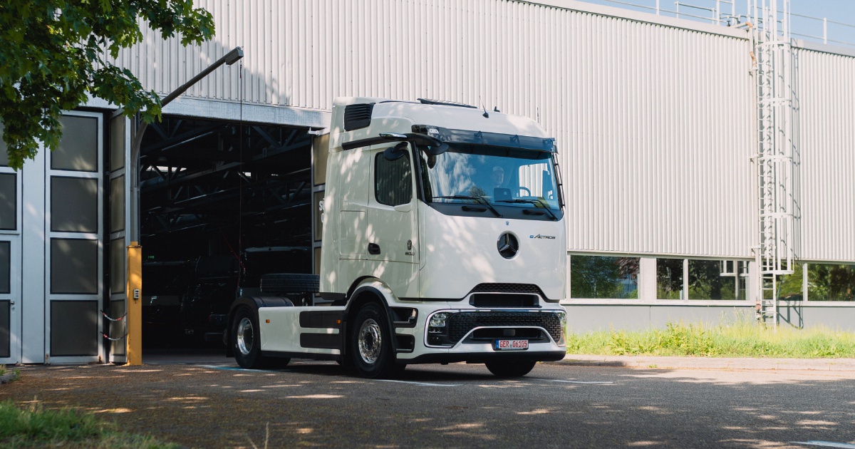

The expedition truck is not a standard tractor-trailer configuration. Wagner and Mercedes settled on a 4×2 rigid platform truck — a single-unit design with no separate trailer — fitted with a custom residential module behind the cab where Wagner will live during the yearlong trip. The build also includes aerodynamic modifications to extend range, extra lighting, new wheels, and custom graphics. The team had to balance low aerodynamic drag against the ground clearance needed for roads well outside Western Europe.
